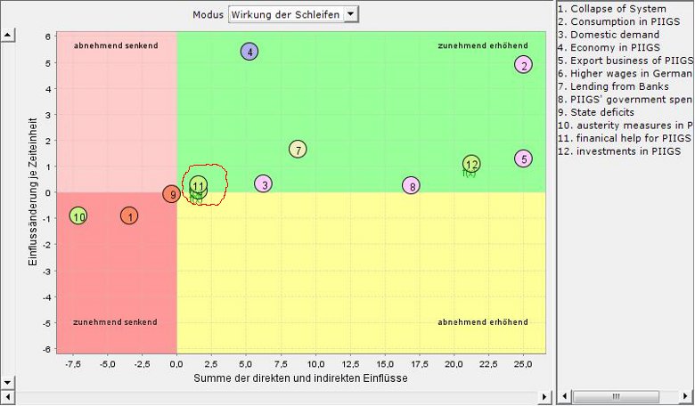

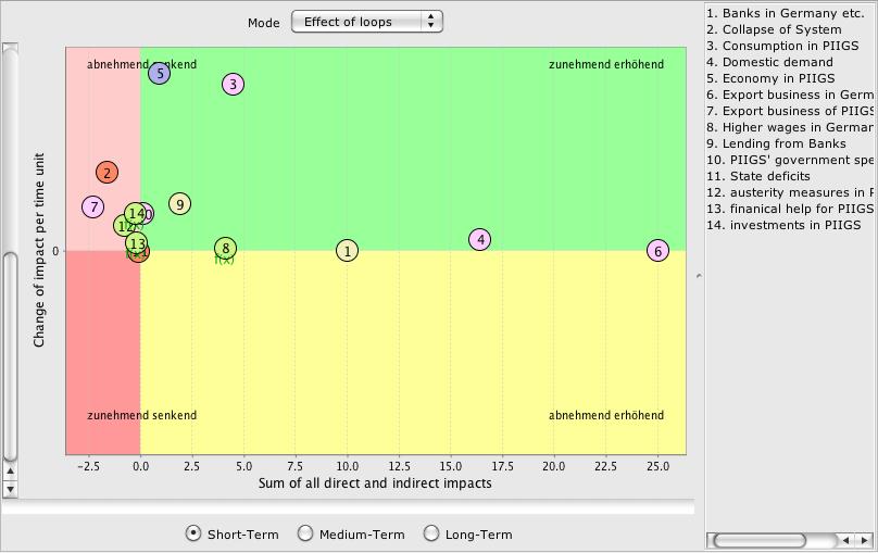

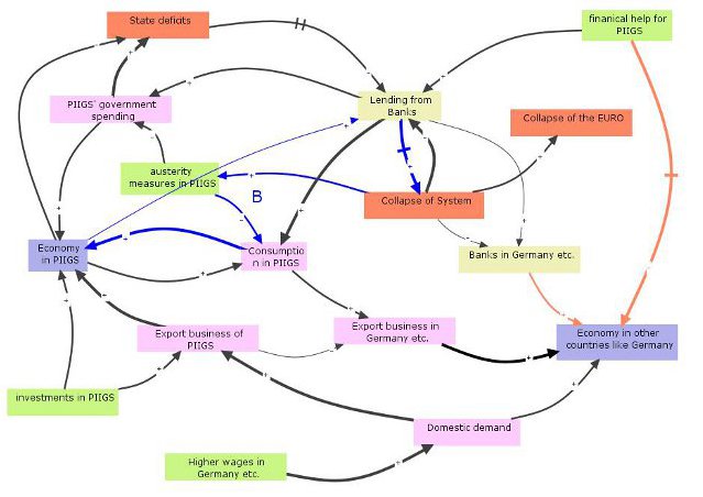

In the rather conservative business magazine 'Wirtschaftswoche' former environmental minister Jürgen Trittin from the Green party offers some interesting insights on the interrelationships between the collapse of the economies of the PIIGS (Portugal, Ireland, Italy, Greece and Spain) countries and the economies of the rest of Europe. He also concludes like I did in my publications that the income e.g. in Germany heavily depends on the income in other countries that in turn either is based on a credit bubble or on our reinvestments in other countries. Also fostering the investments in other countries would an increase of the wages in e.g. Germany to support imports from other countries. That of course is not the short term interest of many lobbyists in rich countries who would like to further benefit from the postponement of the burst of bubbles by the intervention of governments and therefore the taxpayers. It is, by the way, the archetype of shifting the burden.
Well, modeling Mr. Trittin's arguments I was surprised by the results. While he argued that there is no alternative for a rescue action to help those economies the model would allow to argue that the rescue would only be good for our banks and the strategy of Europe.
Nevertheless the rest of the model supports Mr. Trittins arguments, that we need to invest in those countries, support their exports even if they threaten our's, that we desperately need to increase the wages in our countries and that austerity measures in the PIIGS could even worsen the situation.

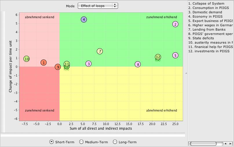

If you look at the insight matrixes of the model you will see that the whole system is quite stable with few escalations of the developments. That came as a surprise to me. I guess only a quantitative model would allow to show that there is a limit to the balancing loops that until now seem to stabilize the reenforcing feedback loops.
O.k. What do you think?
File comment: Insight matrix of the economy in Germany etc.
File comment: Exported graphic of the model

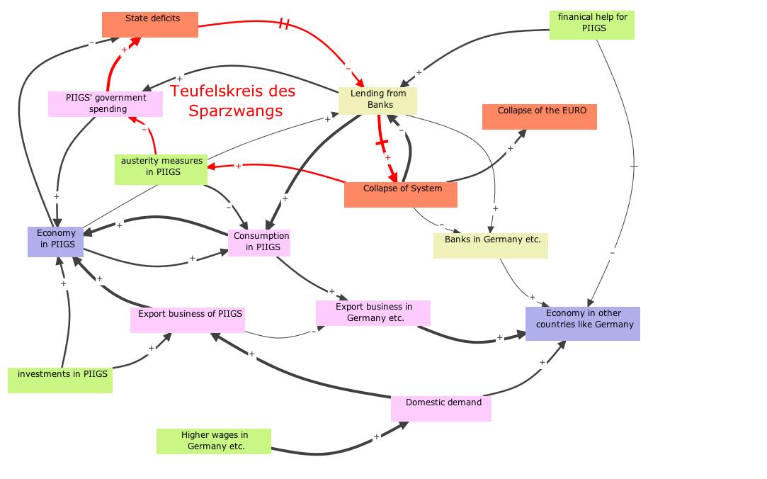

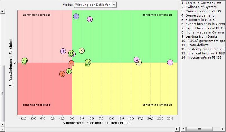

though I havn't read the related article, this is a pretty interesting. I personally think that both, the impact of banks on the economy in Germany and the financial help for ther PIIGS would have stronger impacts, respectivly (arrows marked in red). Doing so, the insight matrix change. Mainly that (not surprisingly) the impact of banks move to the right on the x-axis BUT, that the help for the PIIGS is a quite strong negativ factor on the german economy. though, looking at the impact on the PIIGS economy, the positiv effect is low.
Doing these changes I started wondering, what exactly is behind the direct connection between financial help for PIIGS and economy in countries like germany? ...
Anyway, the consumption in the PIIGS countries remains a main trigger for the export and therefore the economy in Germany. Hence, this would be key (if you like the concept of economic growth).
Generally, I think this small model needs more thinking. From a methodological point of view, the change of single impacts and the interpretation of these changes is a really helpful exercise.
Thanks, for the "food for thinking"... :-)
